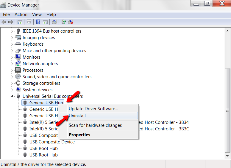

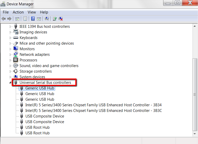

1. Go to Start > Run > type in devmgmt.msc > OK
2. In the Device Manager window, open up the Universal Serial Bus controllers, right-click on each USB Hub/Device/Controller shown, choose Uninstall
3. You will receive a warning that you are about to remove the device from your system. Click on OK. Do the same for every entry under Universal Serial Bus controllers, until they have all been removed.
4. Restart your computer and Windows should automatically detect the new hardware (USB ports) and re-install the generic drivers for it.
